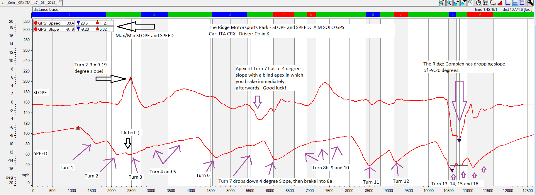

colin_koehler
Great SCOTT!
Here's to making sense of some of my squiggly lines from The Ridge Motorsports Park:
Click on attachment:
The SLOPE line gives you a great perception of the overall elevation change while the SPEED line shows you braking/acceleration.
Bill Bonsell
How'd you do that? Can you overlay several laps and compare times or speed in sections?? Really want to learn how to use the Race Studio software even though I don't have the DL, just the Aim Solo GPS...
Bill-
