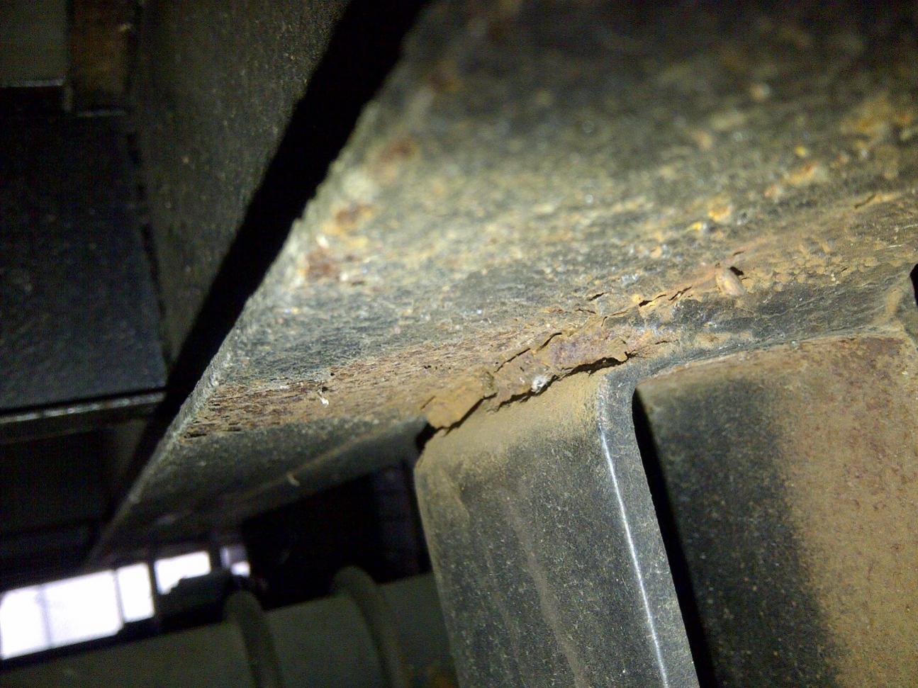

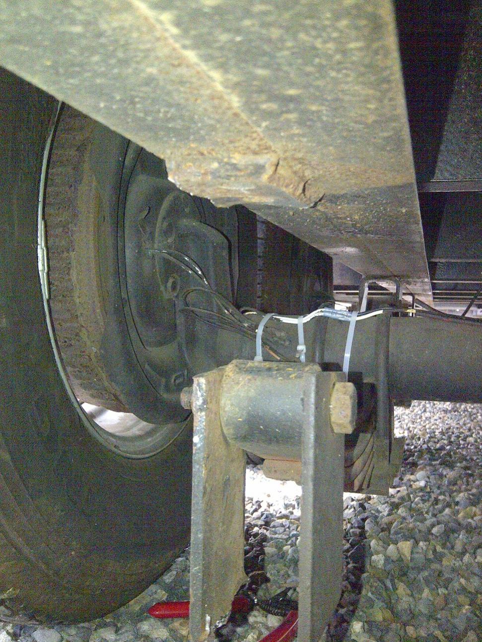

I was under the 3 year old trailer diagnosing the brake wiring (the brake wiring was not supported over the axles and chaffed clear through on both axles) when I discovered a bigger problem. One spring bracket had both vertical tabs broken off and dangling. I don't know why I would assume the welding would be better than the wiring. See below for the failed and "good" spring brackets.

View attachment 1024View attachment 1025
This looks like failure from fatigue, not a failure of a weld. The spring hanger is a piece of flatbar bent into the "U" shape to fit the spring eye, then welded to the trailer frame. Looks like the weld held up just fine.
I also see there is a crack forming on the "good" hanger you pictured. You might want to have that repaired.
The only good way to repair something like this is to cut the weld holding the remaining piece and have a good welder (one who can weld upside down - very difficult - gravity wants to pull the puddle of molten metal downward) replace the hanger.

"I also see there is a crack forming on the "good" hanger you pictured. You might want to have that repaired."
The picture is deceiving - the crack is where the "weld" is stuck to the frame and not stuck to the U bracket.
You are right in that the sides broke from the U bracket, but was it fatigue from the 1000 miles of use, or the fact that only the ends of the U bracket had any useful weld?
I cleaned and re-welded the 4 outer U brackets.
