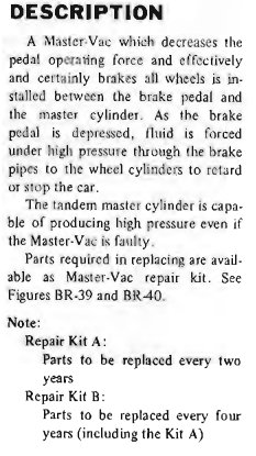

Still not sure what failed but I did find this in service manual which is a bit concerning.
