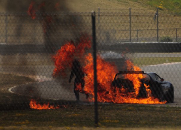

I don't know about anyone else, but I don't worry about dying in a racecar crash. I worry about burning in a racecar after a crash. (After Joey Hand's big wreck in a BMW at Mid-Ohio several years ago, he said the only time he's ever been scared in his professional race career was when he thought the car might catch fire after it finally stopped somersaulting.)
"... he thought the car might catch fire after it finally stopped somersaulting"
I'll echo that same fear from the perspective of response to those incidents.
Often the trade off is comfort for security.
Best of luck in your choices.​
