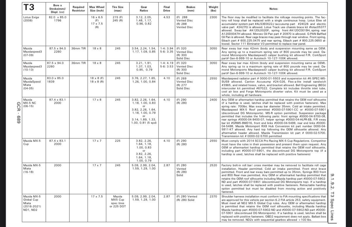

Was reading though GCR and I believe T4 is only for the club model? Mine is a touring so I believe i would be T3 as it doesn’t specify a trim just says NC 06-15. So I believe my intake will be legal. Says cold air intake permitted and doesn’t specify a part #.
Page 690 half way down
Your Touring model is okay for T4. It's confusing how they list cars, and they don't seem to be consistent on how they do it. Sometimes they use commas and sometimes a slash. They list 06-15 but the club model isn't offered in all of those years so it would be a lot cleaner if they did the same as T3 and just say NC MX-5. As long as the car meets the specs in the other columns, you'll be good. The car could also race in T3. They allow a lower weight, larger wheel width, cold air, and a few other things to make the car faster and more competitive in T3. I don't think many NC's go the T3 route though. And unfortunately, Conference doesn't have a T3 or CT3 class, so you'd be looking at probably either ST2 or ST3, EIP, SPU, and ITE as classes that you'd slot into.
